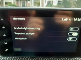

SLH = Geschwindigkeitswarnung + Tempolimit anzeigen
Bezieht sich das auf den Tempomaten, oder auf das NAVI System?

Speed Limit Hold = SLH

Schade, dann habe ich leider nichts davon. Dachte es wäre mit dem Tempomat gekoppelt.

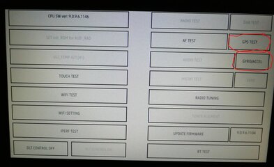

hi all,
First of all thanks for the all great explanation here.
I need some help about my car's media display.
I didn't buy medianav option because the limited supply from the car supplier. So, at my car, I have mediadisplay [SW version:9.0.9.6] But I looked inside the software (Micom) And I tested GPS signal, that was look fine. Probably my car also have GPS antenna.
Here is the my Micom Screen.
I wonder, If I open the GPS or Navi Section under my Micom Test tab, Will the navigation work?
Is there anything to do for activation?
As long your Media Display System hasn't any hardware on the layout you can't use these features. So it doesn't matter if your antenna is preinstalled for it or not cos the receiver hasn't a signal detecting unit. Only Media NAVI got the GPS system onboard.
BTW: You should update your SW to vers. 6.0.9.8. :D
