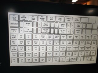

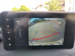

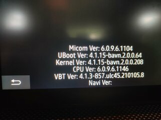

Hello, I need help.. I changed color scheme and welcome sound, but beside that, I have new options for other car models (4x4, drive mode etc...) and my reverse camera is mirrored and lines on camera is angled not straight (see photo) I drive Dacia Sandero Stepway 2022, with Media Display, system version v6.0.9.6. Thanks in advance for help!
Two more photos
