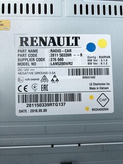

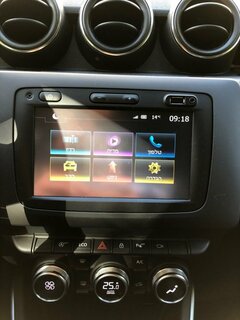

Hello
I have the new Dacia Duster 2018 Prestige
I want to replace Media Nav with android multimedia
Which Android system can fit my car that supports all cameras (4)?
There was no answer anywhere.
Thank you.
Hello
Thank you.
Nothing
You need a multiview modul for android (cost ex. 140€) and many 12V to 6V converters.
Thanks for the answer, what this module is and how it looks, do you have a link to it?
Sorry, cannot open this link.
Maybe someone has the Service Manual Media Nav Evolution with the wiring diagram?
So you mean I need only this (attaching photo), it is cost like all multimedia :o
It seems that I must look for another way.
