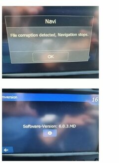

Hi, I have a problem with my Media Nav. I bought it with modified version 7.0.5 MD.
I tried to upgrade it back to factory version 4.0.6 but it stoped upgrading and now when it starts it start in WinCe every time.
I figured it how to start it, going to Storage Card 4/System/Micom manager.But when I turn it off I must do it all over again.
I tried to insert other upgrade.lgu files but it wont star any.
Is there any solutions for my problem??

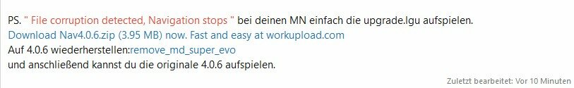

Hallo @mdbokic
versuche mal diese Datei siehe Anhang ist wohl 6.0.3 MD zurück auf 4.0.6.
Hello try this file see attachment is probably 6.0.3 MD back to 4.0.6.

Hi, it wont to start any update when I insert usb drive..
Hallo schaue mal hier : Download DACIA-ori..rar (65.85 MB) now. Fast and easy at workupload.com
und in den folgenden Beiträgen von hier :https://www.dacianer.de/threads/mn-extras-4-0-6.23924/page-2#post-440398
Gruss
Hello look here: Download DACIA-ori..rar (65.85 MB) now. Fast and easy at workupload.com
and in the following posts from here: https://www.dacianer.de/threads/mn-extras-4-0-6.23924/page-2#post-440398
Greeting
