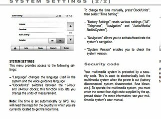

Is your car maybe made for another market and has teh timezone for this market set as default?

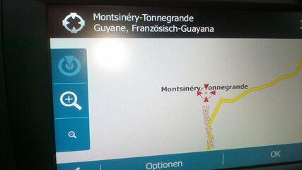

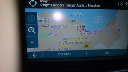

Where are you from?
I am sure someone on this board will be able to help.
