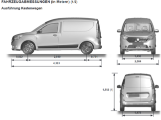

Dakia Dokker
doppelt​
Seite​
4.363 mm​
1.852 mm​
80.803 cm²​
161.606 cm²​
Heck​
1.478 mm​
1.852 mm​
27.373 cm²​
41.059 cm²​
(1,5 fach)​
Dach/Boden​
4.362 mm​
1.478 mm​
64.473 cm²​
128.946 cm²​
Summe​
331.610 cm²​
33 m²​
663,22 €​
20 E / m²​
122,70 Kg​
3,7 Kg / m²​
Zuladung​
530,00 Kg​
verbleibend​
407,30 Kg​
