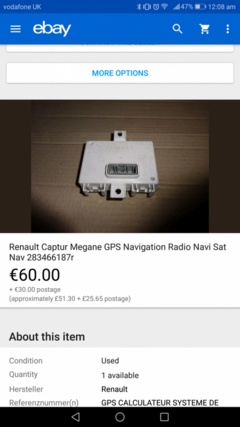

Thanks for your help. This sounds like too much hassle! I Will return my bic as it sounds like it's the wrong model if it doesn't work?
I have a Dacia stepway 2017. Can you link me to a compatible bic I can buy? Thanks!
If you want it to work out of the box, take one that was removed from one of the following models or a Dacia:
Where is the best place to buy? Can you send a link?
See the screenshot. I already have a captur bic
