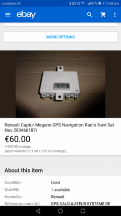

H guys.
I have a Dacia stepway 2017 and recently bought and fitted a media nav v4. I have activated the eco screen.
I've bought the Bic:
I bought an ODB2 splitter and harness as per instructions on page 1.
Have connected it all up but get "-" as the readings.
What am I doing wrong? Thanks in advance!
Wenn du alles richtig gemacht hast, ist wahrscheinlich der falsche Script eingestellt. Needs to be Script 14.
[QUOTE = "lajo, post: 737072, member: 11324"] If you've got everything right, the wrong script is set. Needs to be Script 14. [/ QUOTE]
Thank you for your reply. What do you mean by "the wrong script is set"? What do I have to do?
Change script to 14.
