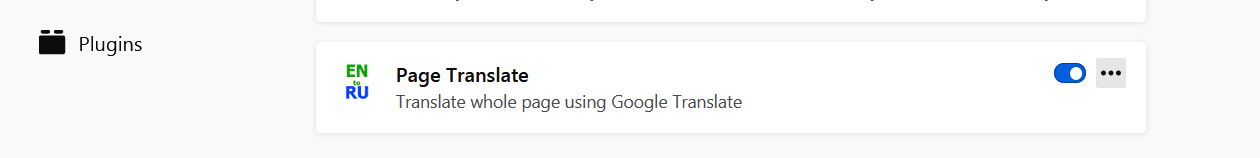

Eine generelle Frage: Wird das Forum automatisch übersetzt? In meinen Emails habe ich den Text auf Englisch erhalten? Englisch wäre übrigens kein Problem, wenn's damit leichter ist!
I have an addon for automatic page translator in my browser Mozzila. You can try it.Ich habe ein Addon für die automatische Seitenübersetzung in meinem Browser Mozilla. Du kannst es versuchen.

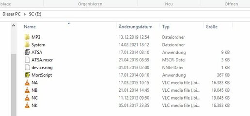

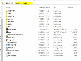

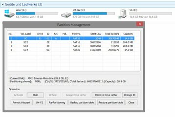

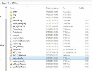

For partition 0 "SC": I am not sure, if I did it correctly. I copied all the files to SC, SC4, SC4. After that, when I press the button "set accessible", SC is visible and accessible in Windows as drive E:. Is that wrong in order to be bootable?
Did you made the last step Set Accesible the first partition SC?
The partition set as Accessible is bootable and must be a Storage Card but at the same time it cannot be seen in Windows.
Yes, I selected the partition "SC" and clicked on "set accessible".
However afterwards it is visible in Windows10.

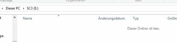

After creating all partitions SC -> SC4, only SC was visible.
Only by clicking on "set accessible" I could make another partition visible in windows - the other were always hidden.
In the beginning: SC was visible and I copied the data. The other partitions were not visible.
Then I made accessible SC2: SC2 was visible and I copied the data. The other partitions were not visible.
Then I made accessible SC4: SC4 was visible and I copied the data. The other partitions were not visible.
Then I made accessible SC: SC was visible. The other partitions were not visible. The MediaNav didn't start from USB.
Then I made accessible SC2: SC2 was visible. The other partitions were not visible. The MediaNav didn't start from USB.

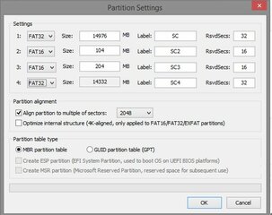

I started a second try: formatted the whole stick and redid the 4 partitions with bootice.
I used these settings
Afterwards I ended again up with for partitions, of which SC was already set accessible and was visible:
(The button set accessible is missing, E is visible in the browser).
Any ideas, what is wrong?

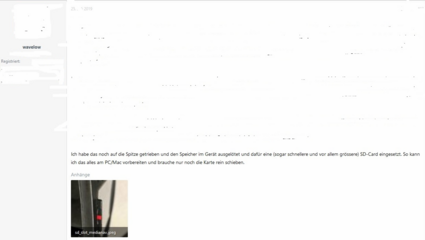

Hallo @hans007 vllt. ist dies eine Möglichkeit für dein Prob (siehe Anlage Objekt 1)oder schreibe @wavelow mal an der
hatte auch fast das selbe Prob und hatte den NAND gegen dies ausgetauscht (Anlage Objekt 2). Aach ja lass dir vom ADM die Freigabe für eine PN geben.
Gruss ;)
