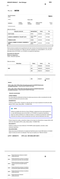

Hello to my german friends, sorry I don't speak german
I want to share with you a serious problem that may have the owners of Dacia Sandero/logan 1.0 65 SCE/ Renault Clio V/Twingo 3.
Engines built between 01/01/2021 and 10/13/21 built in Oyak Bursa factory, there is a technical bulletin number 70513. (engines in question are from engine number R000121 to R052431) In case of abnormal engine noise (such as a moped noise), the engine has a hydraulic tappet valve Non-conformity which causes its damage and the production of abnormal noise from the cylinder head area. Dacia/ renault recommends that in the event of a problem, the entire cylinder head must be changed.
The problem with technical bulletins is that they are "recalls".
So in the case of the 1.0 SCE 65 there are hypothetically about 80,000 engines affected, if you go to the workshop and your car has no problem, they won't change your cylinder head!.
The problem can occur on engines that will start to have this type of problem once the warranty has expired!.
Will Renault gonna pay for the repair? .
The price of the cylinder head of this engine is around €1,800 without VAT! It is a fairly heavy repair that can easily exceed €3,000 with labor.
