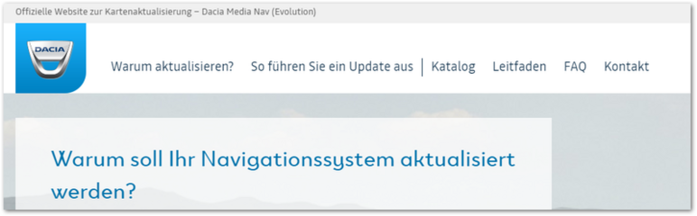

To update you firmware is simple and is decribed also on Dacia site.
Take an empty USB max 32GB format in FAT32, plug in the navigation and create the fingerprint. With this fingerprint in USB go to computer where you have installed the Naviextras Toolbox and with this you get latest update firmware.
With this you just go to car again and install it. Do this always with engine started.
Updating your firmware is simple and is also described on the Dacia site.
Take an empty USB max 32 GB format in FAT32, connect to the navigation and create the fingerprint. This fingerprint on USB you go to a computer where you have the Naviextras Toolbox installed, and thus get the latest update firmware.
With this, you just go back to the car and install it. Do this over with the engine on.
