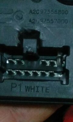

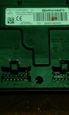

Hello Dacianers, I've arrived here looking for a clue on my sandero's front wipers and interior lights.
After leave my car at a locksmith shop to make a key copy, strange behaviour began
Fron wiper won't work at intermitent (first position) nor stop at the end of its course, cabin light won't
get on when doors were opened
After scaninng using DDT4All and not founded anything wrong, I've removed BCM to get repaired
I've take a picture of that. Two pins bended!. Easy to repair but hard to find.
Sorry for my bad english! cheers!

I don‘t know how helpful authorities would be where you live, but this is definitely something I would report right away. This guy needs either a good job training or simply close down his shop. I feel you buddy.
Nevertheless, merry Xmas
